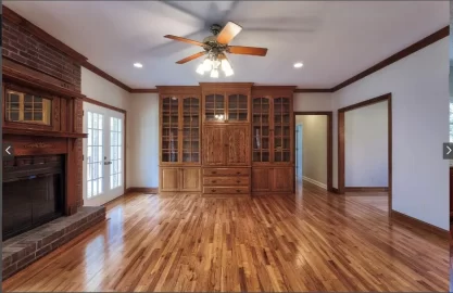

Anyway, there is also a fireplace upstairs that I could put an insert into, but would rather keep the mess downstairs if possible.
