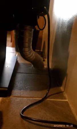

I'm building a new home and have decided to purchase a BK Princess Ultra. I've downloaded the online documents from BK but they don't call out the measurement between the center of the fresh air intake and the center of the stove pipe collar. I need to make certain that with my fresh air intake set in the slab, the stove pipe goes in between my roof trusses that are set on 2' centers.

Here's a pic from my thread:
https://www.hearth.com/talk/threads/highbeams-blaze-king-ultra-install.90089/
The OAK hookup is dead center of the stove and the back of the 3" nipple aligns within a very short distance from the back of stove where the 6" minimum clearance is listed. So from the back of the stove 2" forward to center of OAK. The center of flue spec is in the brochure.

Since you hookup with flex duct to the OAK as shown, you don't need perfection.
The manual diagram shows it's 10.25 inches from the back of the stove to the center of the flue. Does that sound about right? Thanks for the info!
Yes, I just measured 10 with a ruler but accuracy is not perfect trying to measure to center with a double wall chimney installed. The outboard edge of the OAK inlet sits inboard about 1/2" from the back of stove.
Just list whatever measurement you need and I can get it. Will retrieve an actual tape measure if needed. If accuracy is critical I can be relatively accurate.
