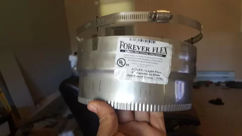

Now may be the perfect time to ask, since the connection between the liner and the insert is covered with cement. For circular insert outlet, how is it normally and safely connected to the liner? a hose clamp? I am just wondering if I can disconnect, scrub the fireplace, and then reconnect myself without damaging the liner?
