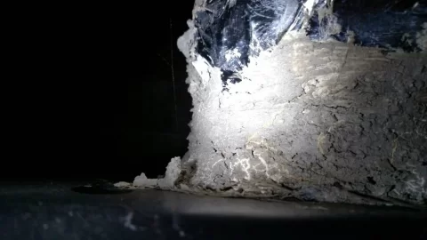

I agree, there are things I know it's beyond my limits, E.g. electrical and plumbing. I could not have installed the insert without their help and by all honesty they did a decent job. But if I called a few places with decent reviews and no one called back, I may end up getting stuck with knocking off the cement and hopefully I can disconnect and slide the insert out with a blanket under the stove.

Is that cement on the outside of the insulation? If so it will come right off, it's not doing anything.
I think so, will find out later this week, I do have to remember to wear gloves to avoid getting cut from the insulation.

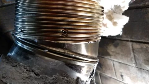

So, knocked cement gently off and peeled back insulation undone 3 screws, now comes the fun part, should I push the liner up while trying to slide the stove out at the same time? Does it look like there's a sleeve or union connecting the liner and insert?
