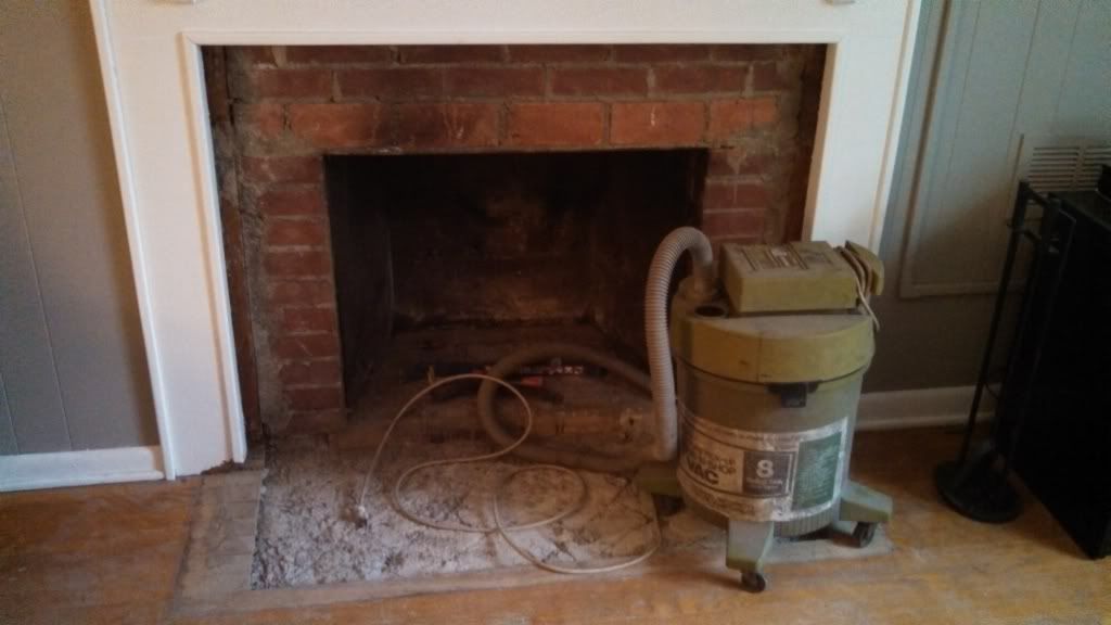

can anyone tell me what the r-value for 1" thick bluestone is?

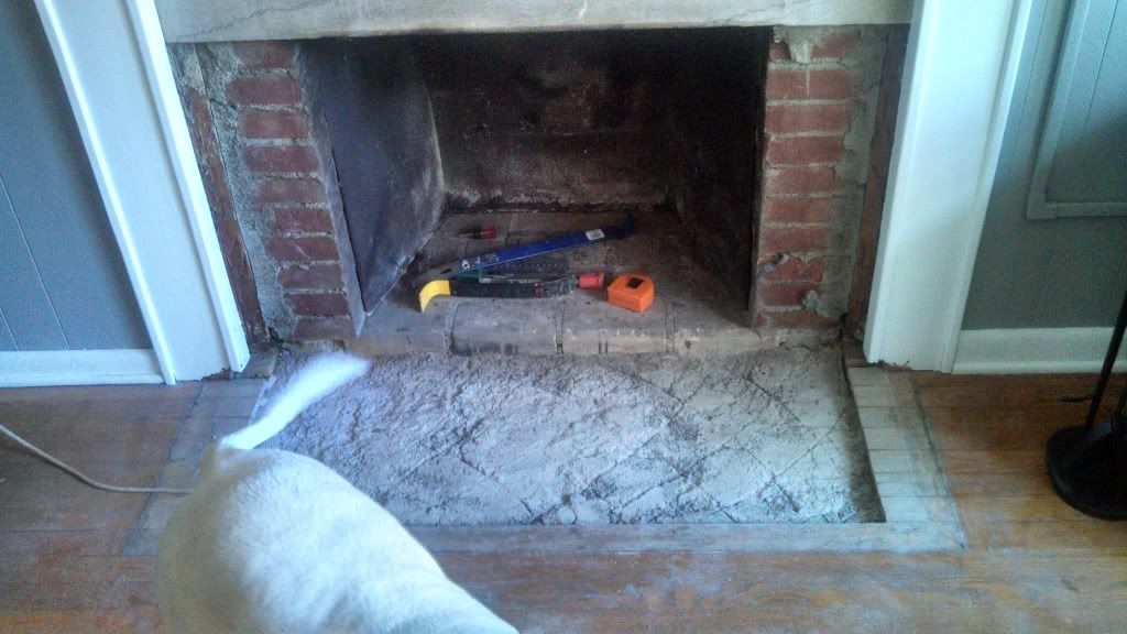

tore out old hearth and looking to bring up my hearth to code for a hampton hi300. I have two inches to bring it up even with the firebrick. Was wondering if an inch of mud and some 1" bluestone would work? Heres a pic of the old one torn out

I don't know, but would expect it to be pretty low. Stone conducts heat fairly well, especially after hours of exposure. My guess would be below R=0.1 .

I agree with BG. I'd look into cutting some more of the wood floor out and making the hearth bigger. What is underneath your wood floor? Or, better yet, do you have any room to raise the stove up in the existing fireplace, so as to possibly build a frame out of steel 2x4 studs and build a raised hearth? That would give you airspace under the hearth, which I think you could vent to the back of the fireplace if done correctly....put a layer of durock down on the studs and put stone or tile on top of that, it'd look really nice to boot!

im cutting 7 more inches out in front. I took out the mortar and marble and its still some kind of cement/concrete on bottom as you can see in the pic, then the subfloor underneath that. No room to raise the hearth at all
That looks like a full masonry fireplace. Most masonry fireplaces do not have floor joists under the hearth they are most often formed and poured in place. If that is the case you already have a non combustible hearth.But I would check first not all masons did it right.
yes the joists stop on the sides of the hearth but the concrete has wooden planks under neath it (looking up from the basement)
How thick is that cement substrate that's under the original hearth? What is the requirements for the Hampton's front clearances and under the stove? I'm betting that if the cement substrate is thick enough, you just may be OK with the bluestone...
not sure how to tell how thick it is? Hearth thickness of .5 for hampton and 18 inches from the glass

Then two layers of Micore and 1" blue stone should be enough.

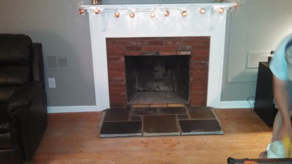

ok got the top marble off, all ready for tomorrow

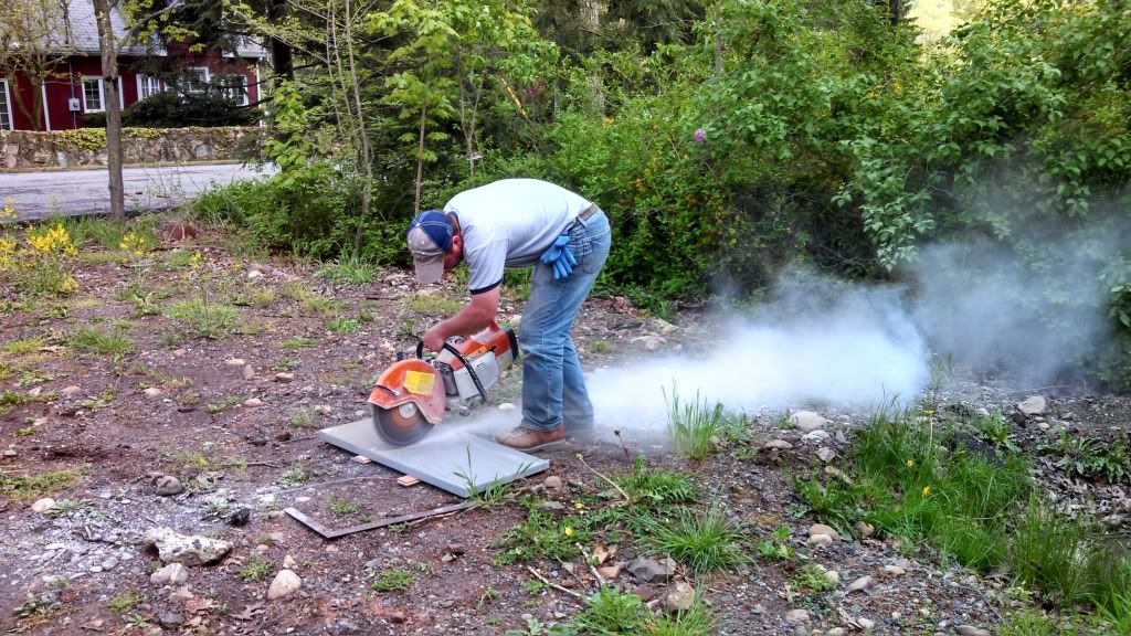

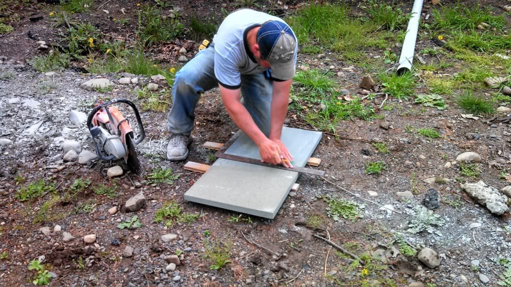

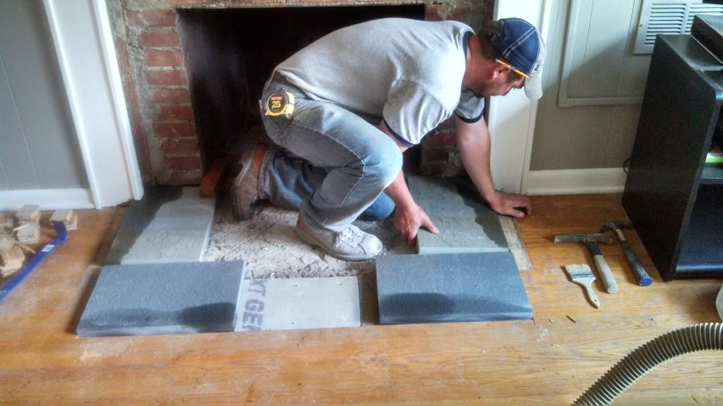

Brother prepped, cut and did a dry layout of the blue stone yesterday. We were gonna set it but figured we would cut back the front and add another course of firebrick to the front of the firebox. He was worried about the heat cracking the blue stone in the front. So that set us back and will have to set it this weekend after the firebrick is set in

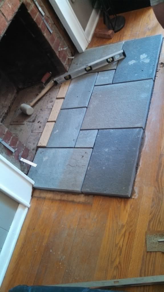

back to work yesterday
