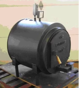

My interest with wood boilers started in the late 70s. Our first boiler was like the one pictured above. In one year it burned 22 cords of dry old growth Douglas fir wood that had lots of bark attached. It was also a write-off at the end of that first year as the metal that was not surrounded by water was burnt out and fractured.

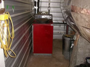

Our second boiler was made in Denmark. A small cast iron sectional down drafter with a triple pass heat exchanger. Its wood consumption was sixteen cords a year. This boiler used the dutch oven concept of a fire box totally surrounded by water. We had to put a tray on the floor underneath it to catch the liquid creosote that would drip out the bottom of the clean out door. I added storage (1046 imperial gallons) to this boiler in hopes of eliminating the creosote on the floor. The creosote now moved from the floor to the chimney. The surprise or prize was that storage dropped its wood consumption to ten cords a year.

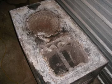

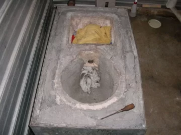

What has given the Jetstream its longevity is the fact that it is easy to repair. It is a very simple boiler; one aquastat to control the blower and circulator.
[Hearth.com] Boiler efficiency and wood use

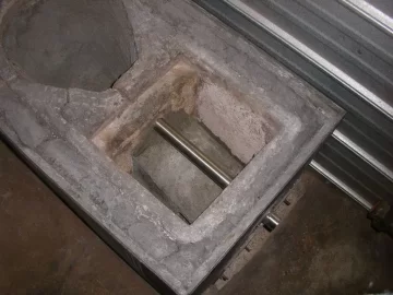

Refractory repair in progress.

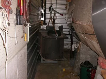

The refractory repair completed. The refractory nozzle below the air injection pipe is easy to make and can be installed in 15 mins. through the clean-out door at the back.[Hearth.com] Boiler efficiency and wood use
The heat exchanger being moved back into position.
