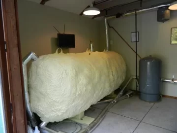

GG, I couldn't see spending the big bucks on the premade store bought stuff so here is how I did mine with homemade insulation. I had leftover fiberglass insulation from my boiler shed build, so I cut it in strips wide enough to go around the pipes I was insulating ( most of which was 1 1/4" black pipe) and about 2" thick. I stuck that to the foil faced bubble insulation from Lowes with some spray contact cement , then wrapped it around the pipes and taped it with leftover house wrap tape. Made for a pretty clean installation and after a few summer test fires I am satisfied with the results. Bruce
