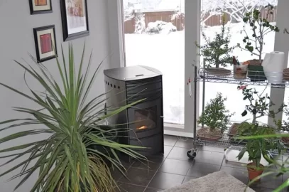

I finally got around to getting a couple of photos of one of my stoves. This is the one on the lower level. It set at a 45 and is setting on a tile floor at the foot of the stair way to the second level.

j-takeman said:
Stove look nice there rooscooter. Blends in rather well. Bet it makes a good boot warmer too!
My lower level is around 1800SF and it stays around 74° with the stove set at either 2 or 3.....weather dependent of course. My upstairs stove (not pictured) keeps the main floor and 1/2 3rd level at 72°. That stove is on a thermostat and it rarely runs above the 2 setting. Although this evening they both are churning away as it's 4° right now.
