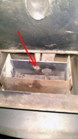

[Hearth.com] Bosca Spirit 500 .... ignitor ? Well I followed the red wire as per the schematic and it goes into a tube that goes eventually into the firepot, about 6" long.
I believe I have an ignitor so how does an ignitor tube work? Seems like the ignitor is back in the tube maybe? It is definately not near the burn pot but the tube extends to the burnpot with hole where I assume the flame/ignitor does its business.
I'll post a pic in a minute

Is there a wire('s) going to the back of it? How about a (Hot Rod inside of it)
The tip on most should be visible from the angle of your pic? I'm not seeing one??
yes there are wires going to the back of it. I measured and it( ignitor) is about 3.5" inside the front opening of the ingnitor tube.
Does that seem like it would still work?
Well, it does seem to be pretty far from the end. Most that I've seen the tip of the ignitor isn't more than about 1/4-1/2" from the end, but maybe that stove design calls for it being that deep. I'd fire the thing up and see what happens.
