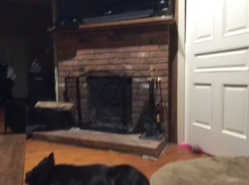

bc got a steal....of course it's about 1 inch too wide for my fireplace. What can I do?

Aside from redoing the entire fireplace opening, nothing.
Sell it and buy a different one
Reactions: madison
What did you buy? Post some decent close up pictures of your fireplace and some dimensions (W/D/H and angles). If you just need to shave the brick facing it may be doable. If you're going to be cutting out firebrick I would move on.

Inserts need a liner, not pipe. The manual will tell you the minimum insert distance. If you can't get it in there at that distance then you need a different insert or modify the firefox ( which may or may not be easy). Otherwise you need a smaller insert. Don't ignore the clearances.

Man that is a small fireplace, looks like a coal fireplace. If that is a masonry fireplace I think your only solution is to sell that insert and buy a freestanding rear vented stove to put in FRONT of that fireplace. You will probably need to tear out the hearth and redo it in front so you have the height to install the stove in front with the liner vented out the back.
Of course to do this properly you are looking at spending some $$, I would not try and shortcut this based on getting a deal.
