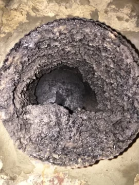

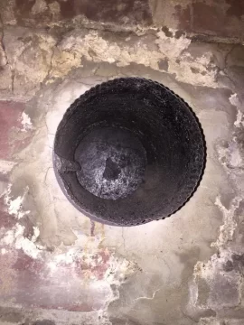

The previous owner assured me he cleaned out the chimney. The first fire I had in the wood stove resulted in a chimney fire. The following day I took the stove pipe apart. I attached a before and after of the thimble. Thank GOD my family wasn't living in the house.

Welcome!! I suggest you stop burning for now. If the second picture is "after cleaning", it doesn't look "clean" to me. Have a certified sweep inspect the chimney and the stove. Ask for advise and start reading the posts on this site. If you already know you are burning unseasoned wood, try to get better wood and buy a moisture meter. Res-plit a split of wood, keep it at room temperature for 12-24 hrs and measure the moisture content. Best is below 20%.

Nope, the Chimney was really clogged too. He did not have a proper brush. Instead, he had a chunk of railroad beam that 'fit' down the chimney, and would just run that up and down it. I don't think he ever cleaned the stove pipe. I invested in a chimney brush, and I ran a camera down the chimney (after cleaning the ever loving chit out of it). It would be ideal to have a steel liner installed (along with a clean out door in the basement), but the tiles aren't in super bad condition.

Your clay is not in good shape i can see cracks directly across from the crock. And there are probably more up through the chimney.

I agree some here do take things a bit to seriously at times including my self. But is seems you are not taking it seriously at all. You chimney has a compromised liner. It probably has tons of creosote on the outside of those clay liners which can catch fire. And no a clean chimney cant catch fire but with the condition of your chimney i doubt you will ever be able to get it that clean without removing the clay.

It is not good i can see substantial cracks through the crock and the sweep said there were more it is not a safe chimney.

Wow, even photo #2 looks dirty in my book. I can’t even believe you burned with #1.
