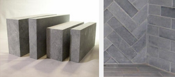

Find a local yard that sells soapstone for soapstone countertops. If none, these folks may cut up some pieces for you.
(broken link removed to https://www.windsorgraniteco.com/warsaw/soapstone-countertops)
