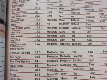

Bought a (Complete guide to the woodlot) magazine. And its firewood btu chart says 22 mbtus per cord for loblolly and short leaf pine.

Understand these are really just estimates, and only meaningful for comparison purposes of wood A vs wood B. These numbers seem to be skewed avg 3-4MBTU higher than chimney sweep's estimates. Your mileage may vary, depending on several factors, like the dryness of your wood and the efficiency of your stove.
