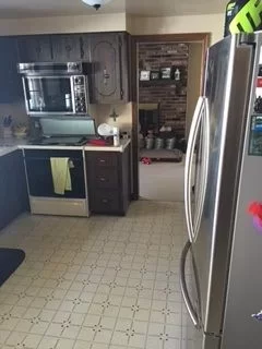

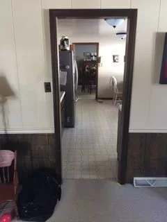

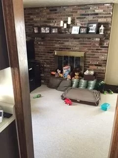

What are the dimensions of the fireplace front, back and depth top and bottom? Would you consider a freestanding stove in front of the fireplace or is an insert the only option? What is the house floor plan like, open or closed off rooms? How open is the stove room to the rest of the house?
Dimensions are 36" Front width, 27" rear width, 22" deep, and 27" high. Rooms are closed off, not an open floor plan at all. Though I will say wife and I have plans to knock down two walls currently separating the family room with the fireplace from the kitchen, and the kitchen wall from the dining room. The fireplace is in a rather small room right now. Opening up the floor plan is a project we have planned in the next 2-3 years.
insert only. freestanding is not an option. The fireplace is located in a small room. Off that room is the kitchen, then dining. bordering the dining is the living room. Upstairs there are 5 bedrooms. my sons' rooms are located directly above the fireplace - these rooms are cold right now b/c the heat pump just isn't getting the job done I think.

The concern is good and healthy. First step is to have the chimney completely and very thoroughly cleaned including the smokeshelf and damper areas. Then comes the planning. You'll need to know the chimney height and inside diameter of the tile liner. If the liner and insert are installed properly with mfg. specs and clearances honored the installation should be safe. Then it is up to the stove operator to practice safe burning practices. How tall is the chimney? Can you safely work on it to install a liner?
You can put a fairly large insert in, but that will cost more and without opening up the room it is going to get very hot in there. The room is going to get hot without opening it up or at least providing some convective assistance. Is there a basement below?

That was what I was thinking. A well insulated duct with a quiet inline fan running from the opposite side (dining room?) to the stove room could improve heat circulation quite a bit. Cooler room air would be pulled in from the far room and blown into the stove room. This would pull warm air from the stove room through the kitchen and into the far room.
