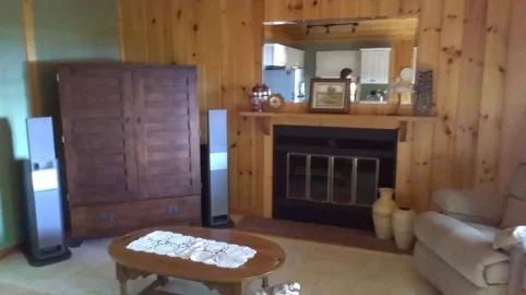

Thanks for the response. I would prefer an insert. Partially because the fireplace is masonry and I just like inserts. This is the best picture I could find & it is from the real estate listing. It is one of the things that 'sold" the home. It gives a pretty good idea of what I am working with.

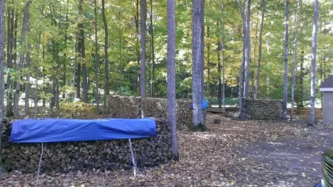

Roger on that. I already have lot's of wood stacked and seasoning (there's more outside of this picture)

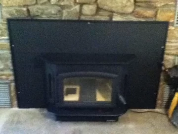

The installer came yesterday at 8:30 sharp. They got busy right away and for the record...Buck Stoves are heavy.
They had to cut out part of the heatilator [?] which turned out to be some fairly hard steel...and took a little longer than expected.
That got done, stove got in, and today they put on the trim, some insulation, and a custom-made cap on the chimney.
We have to paint a couple of minor scratches before we do the low burn to cure the paint.
The installer also screwed the trim panels to the chimney rock to help keep little fingers from pulling it away. Will need to paint those to match as well.

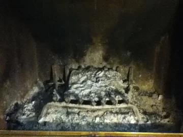

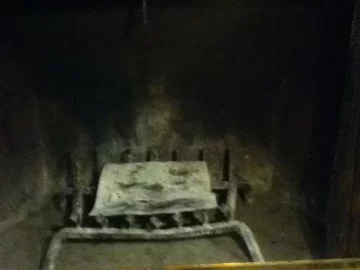

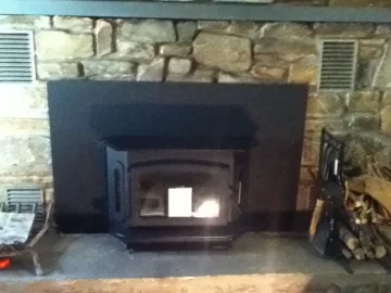

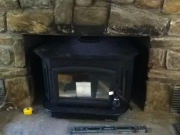

Over all, we are very pleased. When the weather gets cooler, I will post a review.of how it works.Here are some pictures of the transformation. They are grainy because they were taken with a mobile device since the digital is a little fritzy..
In order:
1) Remnants of the last burn. 2) All cleaned up. 3) Getting the stove in place for the liner. 4) Almost done... 5) Finished except for some touch-up paint.

Looking good. The low burn is to dry out the firebrick. Do a full burn and get the stove over 500F to bake-in the paint. Open all windows first.
Thanks...will do. Your laugh of the day.
I explained all this to my kids and my 15 yr old said, "You're going to build a hot fire on purpose and we are going to have to open all the windows in here?" I said, "Yes." She replied, "I really don't understand adults." Made me chuckle. :)
