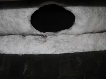

On February 21, 2009 my Dad, brother, and I installed my Buck Stove Model 21. I installed the chimney liner and top plate the afternoon before while the weather was a little warmer hoping to give the top plate glue the best chance for adhesion. When I first wrote that the install was imminent on Hearth.com, I was admonished to "take lots of pictures so other could learn." Here the pictures of the firebox prep work:

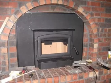

And finishing up...

Very nice install. Quick question, I have the Buck 74 and similar trim kit. (Just posted some pictures earlier today of the hearth remodel) I see that you installed the side panels first, and that seems self explanatory, but how did you mount the top piece after the unit was already slid in? I see the holes where it says to drill and attach it, but wondered how I'd connect the liner since it would be tough to reach if I installed the trim first. I figured maybe it slides under the piece you mount in the back and is not really drilled in, that's what I would do, but the directions confused me somewhat.

Thanks! I'm very happy with the installation. We attached the side pieces with self taping screws, slid the stove in and connected the chimney liner, placed the top trim piece in place and held it while two well placed holes were drilled catching both the top and the side piece where they overlapped. We then used pop rivets to join the top and side trim pieces together. This was based on the advice given to us by the installers where we bought the stove.

Lanning said:
How did the installer use the 3 roller pipes that were laying inside the fireplace?
Did he take them out after the install?
How did that work?
Jim
We installed the stove ourselves (my Dad, brother, and I). The pipe served both to help us roll the stove in and then offset the difference in depth between the exisiting firebox and the higher hearth. This was about a 1 5/8 inch difference and the 1 1/4 inch pipe had a nearly perfect outer diameter. We did put a couple of metal shims under the front end to keep level the stove and to keep it from trying to roll back into the firebox. This also was based on advice of the installer at the store where we bought the stove.
