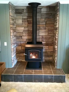

I am looking at installing something like this. Is this a realistic option if I am using a noncombustible material around the wood burning stove?

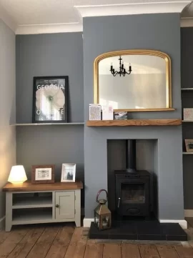

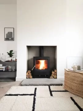

The pictures shown all look like masonry fireplaces. This type of install is more commonly seen in England where they are in an old masonry fireplace with a plaster face. This is not the case if one is building it from scratch typically and it can be a poorer way to heat. A freestanding stove out in the open or in a tall shallow alcove will heat better.

This is a more common alcove install. The stove wall back is not necessary if a cleaner look is desired.

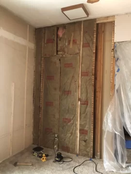

I do not have a design at the moment, I am trying to get an idea of what might even be possible. This is the look I like, and a more shallow alcove would definitely still fit my wants. The space is not huge, and I’d like to maximize what space I have as much as possible.
it is about 6ft long and about 4ft deep. Ideally I don’t want the alcove space to take the entire wall up.

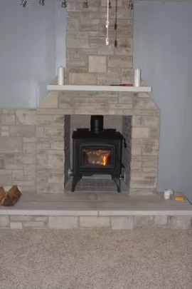

I did a similar install as the first pic you posted. I made it out of metal 2x4's and cement board. its all open on top behind a fake wall. Worked out great for my install.
