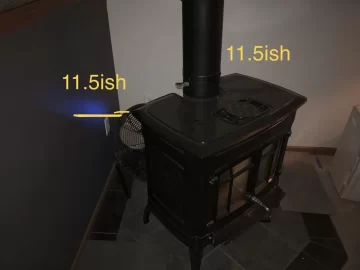

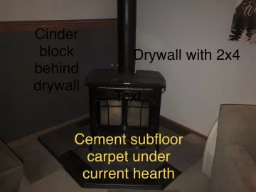

I’m looking to build my own hearth out of tile and then tile the walls as well inarea where stove is...can I simply cut out the drywall on the walls ... add cement backer board (1/2 inch) and then tile that with no concerns? Then just tile the cement floor?
Some pictures provided
It’s a hearth Bennington stove too
Fyi this stove was put in several years ago by a licensed installer not myself
Thanks

Yes, you can remove the drywall and replace it with cement board and tile. If the slab is stable you can tile directly to the cement floor, If not or if cracked, you may want to consider putting down a sheet of cement board to provide a nice level and uniform surface.
So I don’t need a “spacer” behind the wall and a air vent at the junction of the wall and floor?
I’m just confused because the manual says
For a corner places stove acceptable distances to unprotected is
1)13 for single wall connector
2) 12 for double wall connector
And for protected surfaces
1) 7 for single wall connectors
2) 7 for double wall connector
My pipe is double wall
The 11.5 measurement I provided in photo is from the top of the stove not from the stove fire box..not sure that matter
Just want to make sure not violating and safety codes...
The floor we r gonna do the same dimensions if not bigger
Yes, that is correct. Currently the corner clearance is 1/2' shy, because of the drywall. The tile wall does not count as a proper protected surface, but that may not matter. With the proposed construction the nearest combustible will be the studs in the wall, which should fall at 12", right?
Should be...I’m just not sure if the 12 inches is from the closest edge or from the fire box closest point because the top has a 1/2 to 3/4 ledge on it
And the ledge is what I measured the 11.5 from
It is from the closest point. I would just move the stove away from the wall an inch or an inch and a half. I don't like setting a stove at minimum clearance because they move back over time
