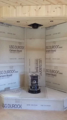

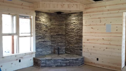

My name is Brian, I am building my own house in the GA mountains (owner builder). I am doing most of the work myself, with my wife's help! I've been reading here for a long time while planning for the house, and y'all have convinced me to go with a Jotul stove. Ive settled on the F500 Oslo, and I'm very happy with the Jotul dealer nearby. Here's a pic of the hearth I built for it. I'm going to cover it with stone
I put in a Duravent class A chimney, its 28' from stove top straight up thru the roof.
Now, I am wondering if the Oslo will be too warm for the house. It is a one story, 2000 sf, very open floor plan. The room the stove is in is 900 sf with a 10' flat ceiling (it's a great room/kitchen/dining all in one open space). The rest of the house also has 10' flat ceilings. I have 6" of cellulose in the walls, and air sealed all walls and ceiling with Certainteed Membrane because everything is tongue and groove knotty pine. What I'm driving at is the house is super insulated and very air tight. I did run a 3" duct to the exterior for the outside air kit (it's in the floor behind the kerosene heater sitting on the hearth now)

Normally for the size of the house I would say the Oslo would be fine . . . but given where you live and the super insulation factor I honestly am not sure if the Oslo would be overkill.
Incidentally, I love the hearth so far and would love to see more of the home.

That will be a nice home for the new stove.
That's a really nice looking hearth for whatever ends up there.

Im almost done with the hearth. Just need to grout the flagstone. I'm hoping to get my stove in the next few weeks. So far nobody has talked me out of the Oslo.
That is a super nice looking hearth! Great job!

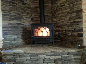

So, I went with the Oslo. I just installed her today and did the first break in fire, got it up to 200 for about an hour burning scraps from my pine tongue and groove. Cant wait to get the break in done and see what she's capable of! The glass got pretty dirty, I guess because the fire didn't get really hot?
I dinged up the DVL pipe a little during the install. I ordered some Stove Bright flat black #6304, which is what M&G says to use on their website. I know begreen had a disaster with this paint, but apparently it is what is now recommended with the new paint M&G is using. Has anyone tried it? I'm hoping to just do a spot touch up and not have to paint the whole pipe.

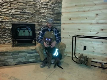

The stove install looks nice, but I am sort of freaked out by your dog.
Sharp looking install . . . cool demon dog.
