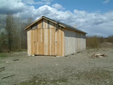

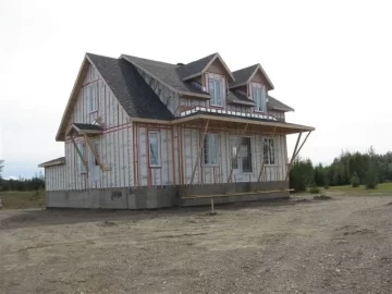

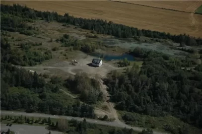

I really need a pole barn like this !!!! I have a land of approx 60 acres where I am building the house now.... no garage yet and my pole barn looks like a out house compare to yours, mine is 14x45 and it's already full of me, my dads & mt borthers junk... I need to build one like 60 x 120 to make sure it going to take a while before it'S full.......
You have a really nice setup and lookis like you have a lot of wood on that land, 50% of mine is an old reclaimed gravel pit, 25% is swamp and the remaining is sick wood... but it's mine (Well, me & my bother, he own 50% of 40 acres out the the 60...)and the land just got paid for (Wish I could said the same thing about the house), and I am only 28.
The good thing too is I have nice seeneries on the River delta and on the sea, but I'm not oin the shore
For your pole, are they burried only or you build like a 2x2 footing where you sat the pole on... or only a 5-6 feet deep buried pole ?

  • [Hearth.com] Built a pole barn in Michigan's UP in winter

It looks like you have a great place there!!!! My poles are 42 inches deep and set on 20 inch round concrete pucks. But the size of the pole pad depends on the size of the building ie how much weight will be on each pole. And the soil conditions a pole set in soft or medium clay will need a bigger pad to support the weight than one set on had clay or sand and gravel which it sounds like you have.
I would have liked to go 100' long but we just could not afford it. But with the 14' high side wall we can put up a 20' lean to on the side and still have it 8' feet high on the low side.
