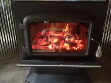

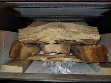

Only got 2 and a half hours out of that load I hope the unseasoned wood is the reason for such a short burn time. It has coals now maybe the load will last longer.

a couple things right off, there's a lot of open space in the prelit picture, the pic of coals is a long ways off from what i personally would call the end of the burn, when those coals are burned down to about half / one third of what they are now i would rake them forward and reload, you have 5 splits in the unburned pic? could prolly get 9 loading them in NS on those coals, that will give you a much longer burn time, also the term burn time is quite subjective.

If you have enough coals, there is no need for kindling upon reload. Pack that thing front to south, and tight. Lose the 2x4s, and those splits are a bit on the small side.

Yep, there is a lot more room in there. If you keep your wood pointing the same direction you'll be able to fit a lot more because it nests better. No need to build a by the book boy scout fire if your wood is decent. Also those coals have more heat to put out before a reload is needed. And finally kindling shouldn't be needed if you have more than about a pint or two worth of coals you can rake to one spot.

Thats funny i think those splits are big. In my regency i found i got the longest burn times with smaller splits i could pack tighter.

They are small for what we normally load the T6 with. This year we have a lot more smaller splits so I will try and compare your method vs our normal large split loads.
Not only that a cold stove and surround will heat up the first load of firewood quick as one should have the air mostly open and fire blazing until up the stove and chimney gets up to temp. So 2.5 hours for the start of fire to get everything up to temp and a big bed of coals would be typical. As other said, let the coals burn for a while, rake to the front, then pack her full and see what you get.

Also, not sure if it was just this load or what, but you can leave the ash in the stove. That will help extend the life of the coals a little as well. It's also less maintenance for you. Shovel out some ash once it starts to reach the inside lip in front of the firebox but generally keep some in. Depending on wood species, you can go weeks without emptying the ash.

And as other said . . . larger splits, no log cabin fires and let the coals run a bit before reloading to maximize the "burn time."

Get that thing packed up, sometimes it's like a jig-saw puzzle to make it all fit all nice and tight. Also, 120 does seem a little warm. I used to put a fan on floor and angled it up at the mantle to keep the heat flowing away from it as much as possible.
