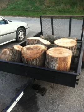

That's funny! Thanks for all the input I'm grabbing a load of hardwood tomorrow from the yard waste site I'll have to make a trip back to grab the ponderosa
