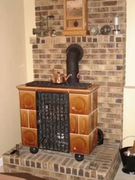

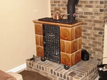

Here are some pics of the stove i have. It's not a "true" masonry or old school kachelofen, but uses the technology of those to radiate heat and circulate air around the tiles.
the hearth is raised 12" and I only have 4" of clearance in front of the stove..
According the instructions and the original importer, they are designed to burn all day/night but require a 20 minute hot burn to clean the creosote build up - twice daily.

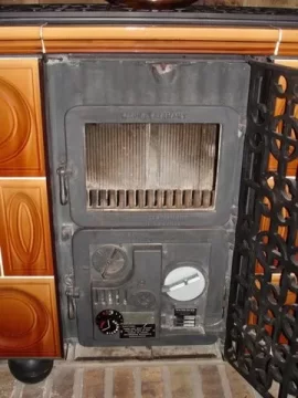

Here's another pic of the loading doors and damper controls. There's a primary controlled by a thermostat and 2ndary dial intake. Like I said, it's also a coal burner, hence all the dampers and shaker grate system.
If any old coal miners on the forum, you'll notice the safety lantern, old fashion annomometer, and you can't see it, but there a really old carbide lantern up there.

Is there floor protection in front of the raised hearth ? If not, I would personally not burn the stove unattended. My worst fear is of the glass fracturing, resulting in an overfire and possible ejection of embers onto the floor. I know the special glass has to go through impact testing, but failure can still occur due to thermal mechanical stress (wrong instalation) or due to a minor surface stress raiser (scratch). For this reason, one should always be sure to adhere to the recommended clearances and potentially exceed the floor protection requirements in front of the stove.
