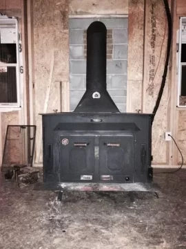

Just finished my install of a 28000 in the basement of our new home
[Hearth.com] Buy old 26000 Buck Stove or new Vogelzang boxwood stove?
Reactions: tfdchief
Looks nice wyo...did you make the legs yourself or is that the stand that is made for the Buck? I was wondering if I could get by mounting it on cinder blocks for the time being.

I believe the stand is made by buck I also have the fireplace screen for it . I've seen somewhere that makes a trapezoid sheet metal stand for them there are 4 holes pre drilled in the bottom of the stove for a stand. Blocks work fine I just preferred a bit more finished appearance
