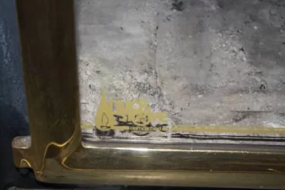

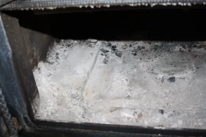

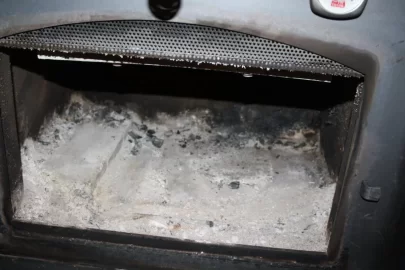

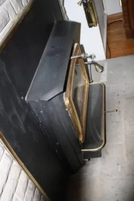

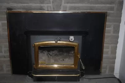

So here are some pics of a Buck 80 being sold for $400 listed this week. It seems Buck has a good rep. What would you look for/ask and what would automatically make you run? This is the response from the owner gettin my initial inquiry:
"It is in excellent condition and needs no repairs. We are getting too old to operate a wood burning stove....ie, carrying wood, etc. This is the ONLY reason we are selling. It is a direct vent through the top of the stove, directly into the chimney. We have original paperwork and instruction manual. It's over 10 years old and we are the original owners. The trim around the door is plated gold." It's still installed in the fireplace, would need buyer to remove (is that normal to have strangers tinkering in your home or are they so simple that loe risk of damage?)

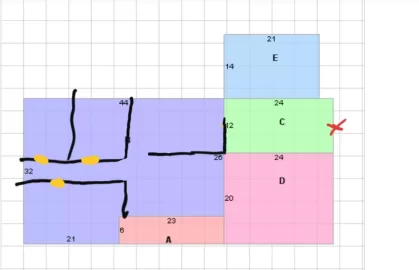

Btw, also adding a layout of my home (unfortunately it's a ranch with the worst layout. The X is the fireplace, A,D, E are outdoor spaces, the gaps in the black lines are openings and the orange dots are bedroom doors). Just wanna make sure the Buck 80 won't run me out of the room (hoping a low burn cat would help) but also see how much I could reasonably try to spread the heat.

Buck makes decent, tough stoves. The price is good, though it will probably need a new catalyst so add a couple hundred to the price.
Heating the far bedrooms in a ranch home is a challenge with a wood stove. A fan on the floor blowing the hallway air toward the stove will help.

Heating the far bedrooms in a ranch home is a challenge with a wood stove. A fan blowing the hallway air toward the stove will help.
Hi, thanks for the response. I guess I should have made clear that I don't expect this to be my main source of heat. Just wondering if I might be able to turn the thermostat down a few notches once we burn on a regular basis. We spend most of our time in the living room or kitchen (connected to the living room) I had a fireplace in the past that I never used because of how inefficient they are and how it makes the room colder (lived in a condo, wasn't allowed to make the needed changes for an insert). But my husband wants to use the fireplace, which is why the repairs are being done with or without an insert.

The insert looks in decent condition and the price is good if nothing wrong. It will be fine for supplemental heat. Make sure the bypass works properly. As noted, the cat probably will need replacing, especially if it is original. Before installing clean thoroughly including the blower.
