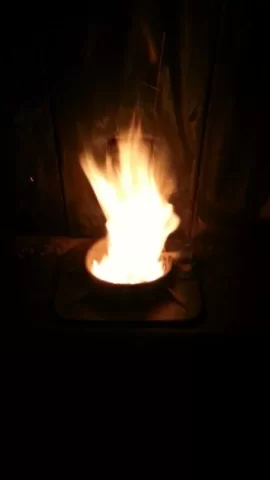

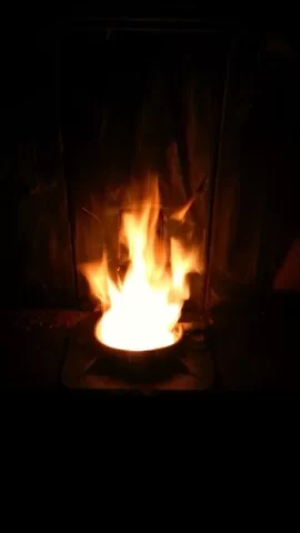

Cab 50 Wont run unless i take side panel off?
Missed it, Smokey! Having to take the side panel off is a strange one UNLESS like you also said, the OAK attachment point is blocked and taking the panel off bypasses it. There's not enough info to really form much of an opinion. The manual says the flame should be 4 to 8" high on HIGH.
Yup and he is getting 3 on medium likely the fuel gate is open too much, it is easy enough to walk right on past the balance point as folks tend to hurry things, that doesn't work at all in setting the air/fuel ratio of a stove when there are delays in response to adjustments.

Looks like there is a heat related event happening

The holes at the bottom of the burn pot are they fully open and is the burn pot floor closed.
ETA: In case you are wondering where I am going,pressure changes inside the firebox as the temperature changes. This can lead to the vacuum system interrupting fuel feed, which in turn causes the temperate to drop once again closing the switch and allowing the feed to continue. This results in more up and down flames than would normally be the case.
There is also a fuel interrupt system on that stove IIRC (I'm old so don't always count on my memory, manuals exist for that reason amongst many). This interrupts fuel feed based upon temperature to prevent over-firing the stove. It also resets itself allowing fuel feed when the temperature drops low enough.
I understand frustrating. When you get the gasket installed I'd set the fuel gate half open and slowly adjust my flame with the stoves heat range set to high. You have to be patient since the adjust requires a full auger load to be burned before the results of the adjustment can be seen. Trust me when I say you will not be the first to miss the sweet spot, nor will you be the last. Patience tends to disappear when frustration is in full control.
