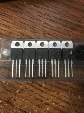

This is a triac you should have 4-5 on your board

If you have a multi- meter you can measure resistance across the triac source and drain pins with board out of stove They are 3 pin devices and the 3rd pin is the gate which turns the device on and allows current to flow between drain and source (aka motor runs).
Compare resistance values between all of them and one should be short circuited, ie low resistance. Or look at stove schematic to trace auger colored wire to stove pin location to help identify triac.
These can be ordered by searching on internet, usually $5 / ea.
