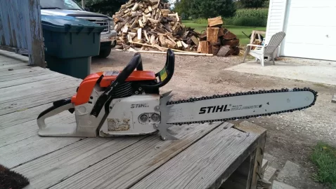

Love it. Dual port muffler with mod, 8 pin rim, 20" bar, new RS full chisel = amazing.
Pulled the 28" with full comp rs thru 28" mulberry with authority, with the 7 pin, and with an untouched single port.

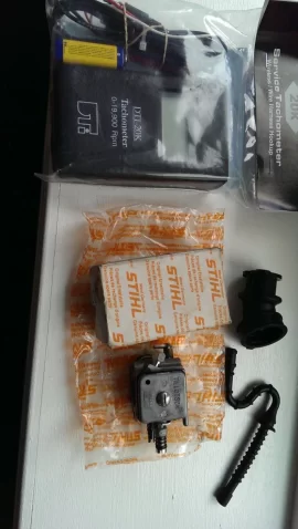

Just got all the rubber fuel parts (fuel line, impulse, intake boot, filter, impulse elbow) today along with a NOS tillotson hk42b carb. That will complete it's journey to better than new. Can't wait to get it into the woods.

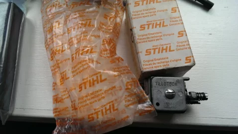

Pretty cool to find the NOS carb. In box, in the bag, with west Germany written all over it. Got a tech tach for an accurate tune after everything.

Was looking for the rebuild kit, but could only find gasket and diaphragm kits. Found that carb for $50 and figured that was easiest.
saw was shutting off when letting off the trigger abruptly following a good cut. Couldn't find any air leaks, but got the rubber bits since I was in there anyway.
Saw was tuned right, started and cut awesome, any wouldn't cut off if I gave it one quick throttle blip following the cut. Really like this saw and want it perfect for winter. Hopefully not chasing my tail here, but I'm learning on the fly.
any technical advice is appreciated.

That's a NOS Tillotson. I'd give twice that for one if I had a use for it. Service replacements are generally Zamas and while they work, they sometimes don't perform as well as the originals.

Sounds like the low end is running pretty fat. Lean it out 1/8 of a turn and see what you've got. They can do that if the LA is not holding the throttle plate open enough either. Should be idling between 2700 to 3000 rpm or so.

The saw will quit stalling with the LA up, but it has to be up close to 3000rpm which spins the chain. It runs and starts good in every other way. Might it just need a clutch that disengages at higher rpm?
I've noticed that the little notch in the throttle plate of the old one is not perfectly round and has black deposits around that spot. The new one has a nice round half circle cut where the old one has a jagged spot around the opening.
For $50 I couldn't go wrong. Definitely eliminates a good sized variable. The saw has been tuned and retuned and always ended up close to the same turns out each time. Tuned by two different people with the same results (I was one).

Walbro WT-194-1 is the best carb for any of the 026/260 line saws. That is all I ran in mine (over a half dozen, early to late models). Some came with a fixed H jet carbs (the worst). The WT-22 was the second best of the 026 carbs (smaller bore than the WT-194).
There is a new one on Ebay now for $56 shipped.

This one engages right about 3K. I'm going to put all the new bits in today, tune with the new tech tach, and we'll see what happens with some good numbers from a usable tach.
They get weak over time from heat. That saw should start to engage the clutch around 36-3800 rpm.
