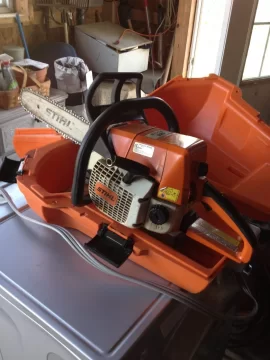

Well I picked up a decent 025 today with 16" bar, new spare chain and case for $190. $150 for the saw and she said 20/case and 20/chain. It turned out to be a co-workers MIL so I didn't haggle, seemed like she could use the money. She told me she loved the saw but had a hard time starting it and had to get her brother to start it for her when she used it. Chain on it was pretty new, but had obviously hit something judging by the cutters, and in cleaning it when I got home it could use a new air filter. I'm pleased with my deal, but... I talked to one of my buddies I used to work with and he made me a deal on his MS360 that I couldn't refuse. He says it needs to be rebuilt. I haven't seen it yet but I told him I'd take it for that price. So, for those that could offer a guy some advice is there something I could/should do if a new jug, piston/rings are needed? As far as performance, if it needs to be rebuilt anyway, what would you do if it were your saw? Thanks in advance for suggestions, and here's the current addition to my Stihl line-up

That looks a lot like a saw (and same story) I looked at in Limerick PA.
That's exactly where I got it haha! I guess you are in the area then?
Yup. I live in Pottstown but spend a lot of time I the Limerick/Ro-Fo area.. I hope you have good luck with the saw.
It seems to run ok I think the low idle needs adjusted. It shuts off after about 5 seconds
Now you have me wondering if there was something wrong with it can you tell me why you didn't buy it?
also, i had my heart set on a 261....
Hmmm... Well an 025/250 is what I was looking for. I have a 391/20" bar new and a 170/14" bar 1.5 yrs old. I was looking for something in between just to have and use occasionally. I got the case and 1 brand new chain, what other accessories was she supposed to have that she did not? While I don't think it was the greatest deal I don't think I did too bad. I guess... Haha oh well all I can do now is hope for the best
She said she had two extra chains and oil and when she showed up for the purchase she only had one extra chain and no oil. she would not adjust the price lower. We agreed on a price of $190.00 (with the extra chains and oil).
I hope the saw will work nicely in your arsenal.
