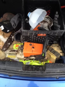

OK Jon, here she is in the trunk of my buddies' car thats rebuilding it. He threw in the milk crate for free also. Enjoy! :oops:

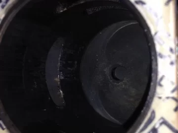

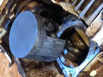

[Hearth.com] CAD struck today [Hearth.com] CAD struck today Update- pics. Looks like it was run on straight gas?
I don't have the expertise to distinguish straight-gassing from the damage that would occur from an air leak or having the carb adjusted too lean, but that is pretty severe scoring on the piston. I'm more curious about the cylinder because it's so uniformly blackened, which I haven't seen before. I can't tell from that pic whether the cylinder is salvageable.
Me either but another buddy said that's what it looked like. I thought the same thing about the cyl but hard to tell from pics. I'm getting a new cylinder and ring/piston kit. They are between $65 -120 depending on the seller and kit content. Hoping to have it running for under $300 total investment
FWIW, Hyway, Raisman and Meteor kits all have good reputations. I would not risk any of the cheaper unbranded versions.
Yup, straight gassed. The scratches are all the way around the piston, and pretty heavy. Usually an air leak will have them concentrated around the exhaust port only due to the heat there.
