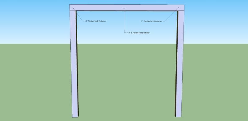

I think maybe I wasn't able to clearly articulate how the beam will be constructed before. It's hard to convey this kind of stuff in words sometimes so I did a few more Sketchup pictures:
Here is phase one:
Calling all hearth.com engineers-strength of a wood beam?
which is simply setting the 4 x 6 beam/lintel on top of the 4 x 6 posts. The unsupported span of the beam is 8'-1". This by itself would probably be relatively strong on its own, but I decided to add the 2 x 8s on either side to stiffen it. My thinking (and please correct me if I'm wrong here) was that the load would really transfer from the 4 x 6 beam through the posts since it rests directly on top of them, but that I'd likely get some deflection under heavy loads, so it would be a good idea to add stiffeners on either side. Therefore the screws are not really carrying a lot of the load, at least so assumes me, the amateur engineer :lol: The 4 x 6 beam will get two 8" Timberlock bolts screwed down through it into the ends of the posts to secure it. The 2 x 8 sandwich will lock it into place, which is phase two.

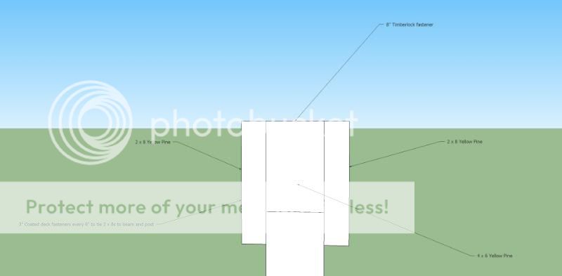

I think the end view gives an even better idea of what I'm doing. I plan on screwing the hell out of the 2 x 8s every 6" or so and what the hell, a good application of construction adhesive would probably be a good idea too.
Every six inches with screws staggered(not in line) would make the single beam you need. Cross that one off the list.

If you think you will lift a 7.3 someday, use 1/2" galv bolts every foot staggered instead of screws.
Additionaly, some kind of diagonal brace from each post to the beam (also bolted) to eliminate wracking and further diminish span is mandatory.
Timber locks into the end grain top of the posts will not be strong enough to prevent wracking.

the general rule of thumb is 1" of header for 1' of span
ex. your span is 8'1" so your header should be 8"s 2-2x8's with 1/2" ply-osb
this would apply for 100lbs per foot LIVE load
however your 4- 2x8 thick so you are way over that rule
you are in the 400lbs per foot live load range
you should be able to easily lift a ton with that
