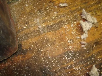

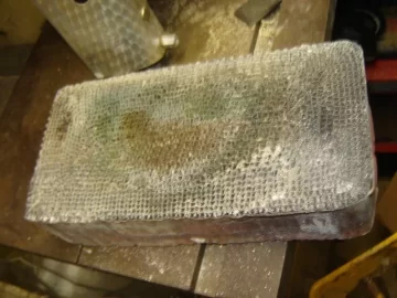

My new SS car arrived yesterday. When I took the old one out of the holder (remember Fireview here) all this metallic powder fell out all over the place. It looked like gold metalflake. I packed up the old one to return it to WS and included the old gasket material with some of that powder on it. The cat is sitting right side up.
  • [Hearth.com] Calling In The Warranty On Woodstock Steel Cat
I had some of that metallic powder as well but is was more silver looking. The gasket pretty much disintegrated in my hands when I pulled the cat out. I wonder if this gasket should be replaced more often?
My gasket held somewhat together, but it had been replaced around New Year's, I think. I stuffed some of the pieces in with the new gasket to keep it tight.
I noticed the same thing as well. Seems like it is the ferrous part of the gasket coming off of it.
