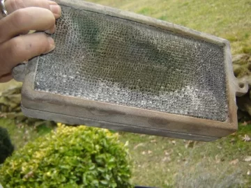

Todd said:
..... they think the greenish color of my cat is chromium and they are trying to figure out the cause and how heat effects it.
Green like this?

Man,that don't look good..very small holes also it seems.

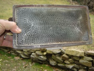

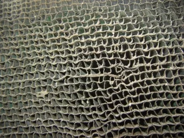

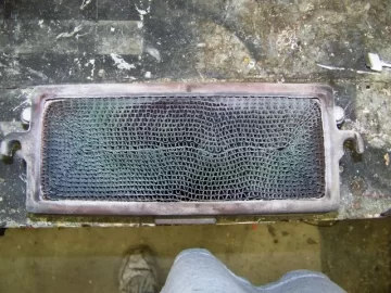

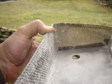

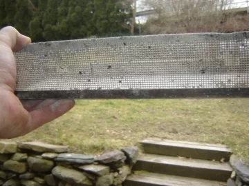

Here's my cat and screen after about a month burning. It took about 10 minutes to remove, clean, and install them both. The only problem is that the stove has to be pretty cool to do this comfortably.

Flatbedford said:
Green like this?
Yep, but mine doesn't get as clogged as yours. What kind of wood are you burning? I'm burning 3 year old Oak.

Is there a coating on the steel, some of the steel ones have a coating dont they?

Chromium tends to be the first thing to burn off on stainless. Look at the color distortions on ss welds, or take a torch to a piece. Each color represent a different temp. I think green is lower on that scale.
Id be concerned that the wash has been compromised, if that was the case. Cr melts at 3465f, Pd 2830f, and Pt 3214f. If the bulk of the wash is palladium, Pd, then id say evidence of chromium burning off posses a problem.
Wheres the master of chemistry, adios? Id suspect he could give us a good breakdown.
I'm burning 2 year CSS oak and my screen was far more clogged than that. The cat was about the same after a month or so of burning.
