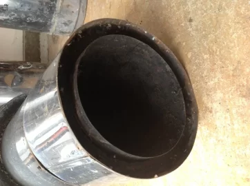

Can anyone identify brand of this stove pipe??

I have several sections of stainless doublewall pipe that i need a TEE for, but I'm finding out that its brand specific. Theres no manufacturer name anywhere on the pipe that i have. Any help identifying it would be greatly appreciated!!

I believe that is made by Security Chimneys International.
Awsome! Thanks savage. Its been driving me nuts. Quick question though. I cant seem to find to buy Security pipe online. Are they merged with duravent possibly???
When you find a dealer, I would for sure send him a picture of both ends to verify before ordering but I think I'm right.
This link will bring up a locator for you if there is one within 100 miles.
http://www.securitychimneys.com/locate/
If you can't find one, here is one in MI.
EclipseDistributing (74.2 mi.)
Dealer
3520 Kraft SE
GRAND RAPID, MI 49512
Phone: 616-301-2060
Fax: 616-301-2061
Is it the same company as duravent?? I saw something indicating that
Can't say that it is but can't say it isn't. However, I doubt it. Can you look up duravent online and compare?
