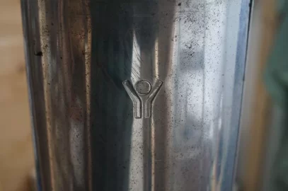

Can anyone identify the brand of my twin wall flue pipe?
SteveHyper
Nov 21, 2017
5
UK
I need to get some parts (single to twin adapter, brackets etc.) but need to know what brand the pipes are to make sure they're compatible. Any help would be much appreciated! I'm in the UK if that helps.
[Hearth.com] Can anyone identify the brand of my twin wall flue pipe? [Hearth.com] Can anyone identify the brand of my twin wall flue pipe? [Hearth.com] Can anyone identify the brand of my twin wall flue pipe? [Hearth.com] Can anyone identify the brand of my twin wall flue pipe? [Hearth.com] Can anyone identify the brand of my twin wall flue pipe?
Selkirk has a bunch of different lines. Looks like old metalbestos to me. Which is not compatible with many current lines.
