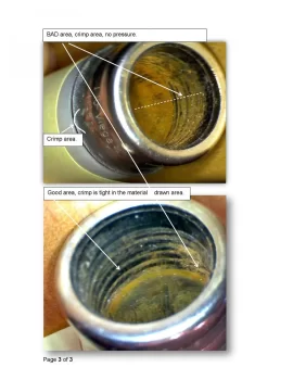

NO, Owlpic has a NEW, two year old house, with 4 crimp failures inside walls and ceiling, both in water and heating system.
We had several plumbers and the manufacture review the failures and everything is in specification. Where the crimps are made there is no crimp-band contact with the PEX, so there is a gap where water can seep through and in one case the PEX hose popped off. See attached Picture.
To understand what is being said, imagine your entire house filled with water, and everything having to be replaced. This is a serious discussion.
This is a serious problem.

Sounds like your plumber wasn't using the go nogo gauge to check that his crimp tool was adjusted to give proper crimps. You know these are adjustable, wear out, and need to be adjusted right? That's why there is a test gauge included when you buy the tool.
Your plumber's crappy workmanship is no reason to condemn a technology that is the new standard.
