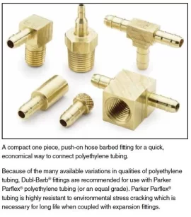

RE: "ridges versus barbs" - a terminology issue? My understanding is that ridges are flat and barbs are angled so that hose pushes on much easier than it comes off.
Yes both types are called Barbs, as shown below and have been around long before Pex.
SEE: http://www.parker.com/literature/Brass Products/3501E-I.pdf
