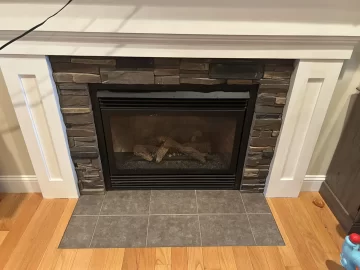

Before I waste my time any further, was wondering if this propane gas fireplace can be reasonably converted to a wood insert with a new class A chimney?
I hate gas! Thanks.

Very unlikely. A wood burning system has quite different requirements for chimney, clearances, and heat protection. It might be easier to locate a freestanding stove elsewhere.

I understand all of that. I meant to tear out the gas unit, install a insert assuming all clearances are met, and installing a new class A chimney thru the wall or up and out. Was just wondering if anyone has run into this type of set up.
With a lot of good planning it may be possible but challenging. In this case the replacement would be a Zero Clearance fireplace. An "insert" goes into an existing masonry fireplace.
Take lots of measurements. Gas fireplaces are often shallower than wood ZC fireplaces but there are some shallow wood burners like the Pacific Energy FP16 that might work. It's 18" deep where many are 24" deep. The mantel and front facade would need to be redone. Then there is the chimney alignment with the bumpout roof framing, then the house eave.

Thank you for the info!
