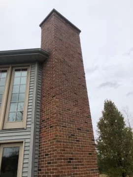

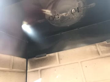

Is there clear things to look for to tell if I can change a gas insert into a wood insert or wood stove?
Far as I can tell it probably only has the liners for gas inserts. But the top does look like a regular clay flue.
[Hearth.com] Can I convert gas insert to wood? [Hearth.com] Can I convert gas insert to wood? [Hearth.com] Can I convert gas insert to wood? [Hearth.com] Can I convert gas insert to wood?

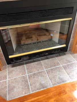

Ok the fireplace looks like a regular zero clearance unit. But it looks like a solid glass front wich would mean gas only. But the chimney looks like a masonry structure. What you have makes no sense to me at all. Have you had a pro look at it yet?
I have not. Just starting to talk myself into doing this all over again...renovated a house got a nice PE insert to only need more bedrooms... so this new house the original owners had requested wood burning and not sure if the builder just had 2 of these laying around and pulled a quick one or what.
Problem is I am not sure of a competent installer near me. The dealer I bought the PE from I wouldn’t trust on a install at all.

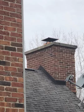

This is going to take some on site inspecting. Have a pro come out and inspect the flue to see if it is masonry all the way down to the stove or not. What the pictures show sure looks like a zero clearance unit. The chimney structure looks like a masonry fireplace, but maybe it is only a veneer?
Reactions: bholler
Should I be able to tell if I get up on the roof and look down the flue? I mean if its clay flue with 2 liners coming up it then it should a full functional masonry chimney correct?
Chimney yes, possibly, but it would still need a full and proper masonry fireplace for an insert. While checking measure the ID of the flue tile.
So if its not could I put a free standing stove in front and then go up through with class a pipe?
Possibly. We dont know what you have it looks odd so we cant give you many answers
