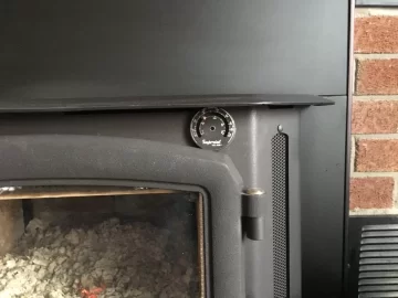

It's above the door, and maybe about where the top of the stove intersects the front? That's where I had it on the Buck 91, it would get up to 500 or more. If I opened the door and shot the stove top from inside, it was 150-200 hotter. Then again, the cat was mounted to the bottom of the stove top not far from there so maybe that came into play as well.

Really I don't mean to harp on this. I just know my door reads much cooler than my top. Just trying to get a number that can reasonably be compared to other stoves so I could understand if he's actually running cool or just undersized.
The airwash that keeps the glass clean comes down over the glass and turns back into the fire at the bottom. Keeps the door cooler than the stove top. Even cooler than the face of the stove on either side of the door.

Hi , I did a few things yesterday night. I chose logs in my garage that I am pretty sure have no more than 20% humidity . Load up at 6pm, got a 400F reading after one hour and another load at 10 pm. Fire was rolling and I got a nice 74 F in the house. Now, it was cold during the night , -15 F, this morning at 7am , I had a good bed of red coals but the fan was off because the is stove not hot enough.Normal. I put in a few smaller logs and get it going again. I set my gauge temp right on the top right corner of the unit, just over the door as I usually do. I will check the gauge in the kitchen oven at 400F for what it is worth. I will also check it on the top shell of the unit which I think is not getting as hot as where I usually put it, on the front part. That will give me a general idea of the accuracy of the gauge and the best place to stick the gauge. I might just go buy another similar gauge and put it on the top part and compare the reading with the other gauge on the front spot. I will let you know what the reading are. See pic, this is where I stick the gauge on my I2400 and I1300.
Plus radiation doesn't hit the door itself since the front of the stove shields it, and the door is isolated from the front by the gasket.
