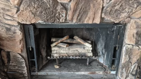

Rather hilarious to me that this thread has activity just yesterday. We just had a huge ice storm that knocked out power for several days and I had no heat source except a Heatilator fireplace I'm afraid to use, so it was quite cold. I'm afraid to use it because it completely lacks the door assembly, some of the parts are taken apart, the side vent louvers have dead wasp nests in them, the damper chain is broken and won't stay closed, and I have no idea if it's safe up in the chimney. The short story is it looks like the previous owner was in the process of doing something, then died, then the family threw everything out.
I really don't want to replace the whole thing as it will be a hugely expensive demo project that will absolutely ruin the nice rock veneer around the whole thing.
Good news is the blower works...
[Hearth.com] Can I get this fireplace going?
Yeah, I found a lighted fake log thing and a screen to put in front so it doesn't look so terrible, but I want to get it restored to working condition.
Any help?

The fireplace should be inspected by a good sweep. Do you know the make and model of the fireplace?

OK, that was a popular unit in the 1970s. This thread just talked about it.
The damper chain assembly is still sold here:
I'm thinking the previous owner had the same problem as the OP of that thread. Probably tried to fix or replace the doors and ended up getting stuck.
I'll get ahold of Stoll and see what they can do. In the meantime looking for chimney sweeps.
I've actually got two problems with the flue chain: It's missing the pull handle and maybe the bottom six inches of chain, and the flue is spring-loaded and I can't find any place to secure the chain to keep it closed. I don't feel like it's worth $68 for a chain I can get for a buck a foot. The trick is I guess I need something like this and to know where to put it. Looks like it's supposed to be at the top of the front of the fire box.
