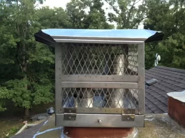

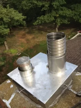

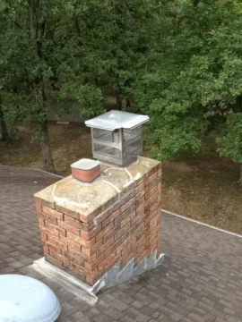

I also installed 2 flex liners about a month ago. One 4" for the vent and one 3" for the outside air. First I removed the movable part of the damper. Then I used a 1/4 inch rope with a funnel duck taped to the front end of the liner. I pulled the rope from the roof up the chimney while my wife fed the liner thru the damper area from below. It took about 45 total minutes to get both liners in place. Very easy install.
I used a prairie style ( coliner) cap on top of the chimney.
I made a block off plate above the stove and used Roxul insulation above the block off plate, in the damper area and below the top cap. I did not insulate either flex other that listed above.
I had problems with the stove adapter that I used. When the 4" flex was attached to the adapter it came in contact with the top of the stove so I had to remove the factory installed stove exhaust from the combo blower and reposition it so that I had clearance.
