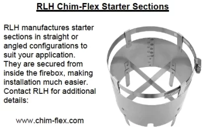

Expedition II lists the minimum height as 23 3/8" which we have, but the installer said they need more room than what's listed so they can get their hands above the insert to connect the flue, etc.
There are flue liner starters made for tight situations. The liner is pulled and attached from inside the stove.
It's also sold by integrityventingsystems.com
I think there are other companies making them too.

For alternatives, look at the Lopi Answer insert. It's 20" high. Or the Evergreen at 23" tall. Note that the Lopi Evergreen manual shows the liner starter in the post above in the Flue Installation part of the manual. You can show this to your installer.
This shouldn't be a big deal. There are other inserts that will fit like the 21" Drolet 1500 Escape insert or the True North TN20 at 20 1/8" tall or PE Super at 20 7/8" tall.

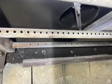

vbu
Feeling the Heat
Mar 3, 2019
253
MS
This is what I was trying to describe. The liner is attached from the inside of the stove
