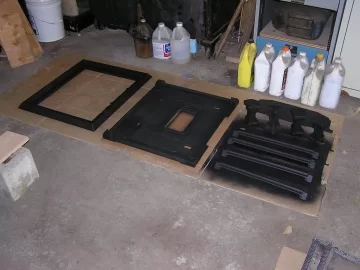

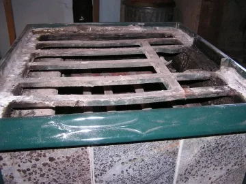

I had the enamel blasted off of mine at a professional shop. I'm not sure what media they used. Most of the parts were cleaned down to the iron, but some had enamel left behind. The parts with enamel left on them took the paint just fine. One season later everything still looks great.
