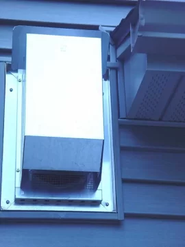

My Lennox gas fireplace was installed incorrectly (exhaust too close to soffit), and the installer and builder did not believe me (they obviously never read even basic instructions), so I contacted Lennox and sent them pictures. They confirmed it was wrong, and building cut back the soffit to 6" as per instructions.
  • [Hearth.com] Can the dealer or manufacturer advise changing specs contary to the products' listing
