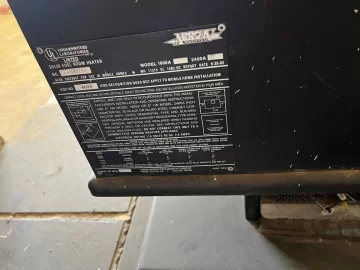

A wood stove was installed in a manufactured house which we purchased couple months ago.
Can you let me know if the wood stove is compatible with manufactured house?
Thank you.

Can you get a better picture? This one is too blurry.
[Hearth.com] Can you check if my wood stove is compatible with manufactured house?
I attached a higher resolution.
Please download the file and enlarge.
I just saw the aluminum tag and I got to know that the stove is good for manufactured house.
By the way, my local stove store told me that wood stove for manufactured house has to have hole at the bottom of the stove to get air.
I don't think there is no hole at the bottom of the stove.
Thank you.

And most wood stoves rated for mobile homes require a out side air kit which is the whole they are talking about.

According to the manual, the outside air enters the stove thru a hole the bottom of the pedestal & travels thru the pedestal into the firebox .
