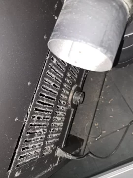

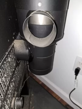

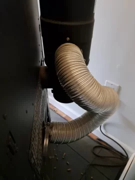

Here are some pics of before and after I took the hose off.
After taking the hose off I definitely feel cold air coming through the pipe

Ok, yes that’s the correct way, it’s a high efficiency set up by the looks of it
Yeah for sure! And not a problem, stay warm!
