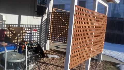

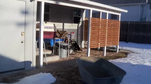

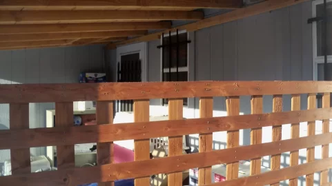

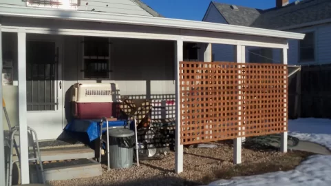

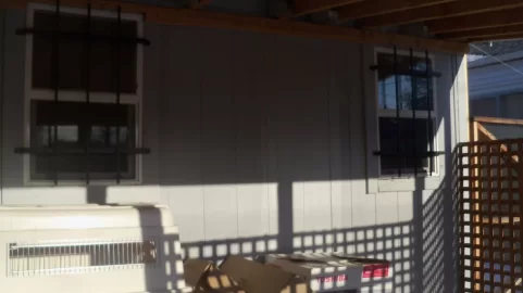

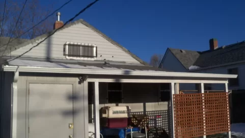

send us photos of the porch inside and out...

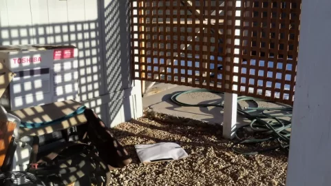

Could not get in some positions because of snow and it was slippery and the white cardboard is the size of the stove: High 27.5 Depth: 14.5 and width 15.5.. It is top corners closest to house is situated at 20 inches straight to wall on each side....One direction from a advertisement was : Stove to side wall 20 inches and Stove to rear wall 6 inches and stove to corner 14 inches.. My second choice would be in the middle of the two windows straight on would give more room and maybe since I am raising the stove about 10 inches so I do not have to bend down so low to load it maybe if wide enough people could sit around it. So I could have it catty corner or straight between the two windows...What do you all think..? thanks..clancey.. Also do bricks retain heat better than tile for a stove and would just bricks be better.. The tile picture is post number one...But if bricks retain heat would that be better and maybe more protection and would look more like a hearth as well--what do you think..." enticement here----I love you all " Thank you..clancey;

You got that place barred up like Fort Knox. I'd be putting the stove as central of the house as I could, but that's just me.
Yea those security bars look funny I would imagine and your little note on your account " about living next to a nuke plant" for that I would have a Geiger Counter placed somewhere--- lol. Quite a few people think that I should bring the wood stove into the main part of the house and you are not alone with this thinking which is a good idea if I was to use it for my heat source but in this case I want it only for emergency purposes as well as a chance to learn about heating with wood. Some of these stoves are just beautiful and would add beauty to any home and ambiance as well but for me I just want to use it for emergencies in case the power goes off on a freezing winter day so I can stay at home and be warm--I hate the cold. If I were to place it in the house it would be just as you suggested in the middle of the house..Thanks for the suggestion ---clancey.
