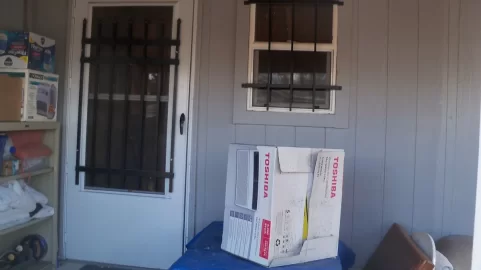

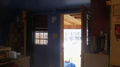

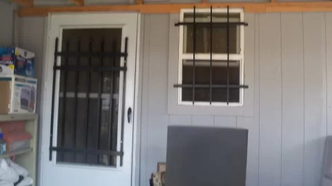

So this is how I am figuring to put the wood stove at a angle like the box is set up on the outside of the house in the porch area.
That angle would face the inside of the kitchen as well as the two wooden entrances that goes to the other 2 rooms. Next looking from inside to outside towards the window and door would it be beneficial to put a slider in that area so that I can get heat to the house from my J.A. Roby Sirius wood cook stove..It is 31 inches high about and that table is 30 inches and the box is in position at the right angle.. This is the question of this day and do you still think it might be too hot of a burn and could I transfer that heat into my main house consisting of what you see--poor folk here--me....clancey...Thanks..

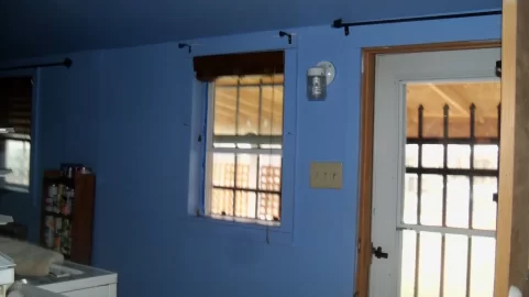

There's no need to angle the stove. Its hearth will take up a bit more room that way and there will be little to no gain from a heating standpoint. The most efficient way to have the stove share the heat with the house is to place a fan in the kitchen side, low or on the floor, blowing the cooler house air into the hotter porch area. The displaced cool air will be replaced by warmer air at the top of the door opening. That table fan running on low speed would work fine. No need for a patio door, it's the opening size between the rooms that matters. If the patio door opening is 36" then it is no more effective than a standard 36" door left open.
What a great idea but I am figuring different now and this is me is such a beautiful stove---I love it.. Cannot help myself...lol I might want to learn to supplement heat in my house and burn my stove more often as well. So ---Take a guess----" I am going to tear that back wall down where the door and the window is and make my stove part of my house. This will give me a area of 12 feet across and 5 foot down towards the yard.. Only this short is because of the low ceiling and this is where I must stop for a tall person to walk down steps to clear the head height. The floor will be raised at this point level with the house up until 5 feet out then the steps will start down to the ground (2 steps).. The porch area will be raised 10 inches to make it level with the kitchen floor.. This stove will become part of my house and if I am going to spend this much money on tile work or bricks I might as well make it beautiful to where it becomes part of this old house..I believe the stove piping will be about in the middle of the roof area with bricks behind and the stove straight on facing the kitchen.. That will give this heat from the stove full access to the rest of the house as well as protecting my piping if everything goes to complete blackout..One of the other posters on this forum mentioned "water pipes" and I never though of this but its true--why have a porch 90 degrees when my pipes in the house might freeze up---never thought about that...lol lol I am old but new at this,,,lol Thanks..Let me know what you think and if this might work? Always new developments here and we are working our way through this quest...I will call my electrician on Monday to set up a appointment to play with the wires and lighting on that wall...or disconnect--whatever he does--he"s a expert..Thanks..Clancey

Could not get in some positions because of snow and it was slippery and the white cardboard is the size of the stove: High 27.5 Depth: 14.5 and width 15.5.. It is top corners closest to house is situated at 20 inches straight to wall on each side....One direction from a advertisement was : Stove to side wall 20 inches and Stove to rear wall 6 inches and stove to corner 14 inches.. My second choice would be in the middle of the two windows straight on would give more room and maybe since I am raising the stove about 10 inches so I do not have to bend down so low to load it maybe if wide enough people could sit around it. So I could have it catty corner or straight between the two windows...What do you all think..? thanks..clancey.. Also do bricks retain heat better than tile for a stove and would just bricks be better.. The tile picture is post number one...But if bricks retain heat would that be better and maybe more protection and would look more like a hearth as well--what do you think..." enticement here----I love you all " Thank you..clancey;

My installer and I walked through my project of putting in a wood burning stove to get ready to place it at the right location for clearances and legal installment. We place the "card board copy" at the right locations --10 inches from the rear wall and 20 inches from the side wall and 8 inches to the corner. This wall will be dry walled and he said as long as we abide by the clearances that brick or rock facing is unnecessary. To my thinking this would make it safer if there was a heat shield attached that was one inch from the dry wall to give it air flow behind it. My question is "Do I have to have anything else on the wall if we abide by the clearances and would a heat shield in your estimation be of any benefit?.. The piping will be 12 foot and it is straight until it gets to the 2.4 and then there is a elbow that connects to some kind of box inside the ceiling and continues through the roof to the rest of the height and I questioned him about that elbow and asked if I could have just a straight pipe and he looked at the spaces between the 2x4's on the roofing and said that would then not clear other things in the porch and the elbow was needed..My question is will this elbow interfere with the cleaning or air flow to this wood stove..? Just wondering...I ordered a 48 inch french doors that I will place on my porch back wall so that I can open it to let heat into the house if need be and we marked clearances from that as well. I also have a 36 inch door that goes out to the driveway and we marked clearances from that as well for it will swing against the wall side.. I also will have a window in the middle of the porch outer side that is 24 inch in height and 30 inch in width that I ordered years ago as a special order and now it is coming in handy.. So this project is going forward and just wanted to ask you people about all of these questions that I have in regard to this installation...I am slowly going out of my mind---lol lol--but this project is moving forward nicely and tomorrow the 48 inch french doors will arrive...So I am getting excited...Surely appreciate your time with me on this project and the floor will be concrete all the way in the room and will have what you suggested laid down first 2 inch EPS expanded polystyrene put under the 4 inch concrete..The stove will be raised 3 inches to make it 36 inch high and this will be a concrete pad secured under the stove to raise its height----continuing and once again--thanks for your help and encouragement always appreciate...clancey
If clearances are honored then there is no need for additional wall protection unless one wants greater peace of mind. In that case, a veneer of regular brick would suffice with no air gap. Or the wall behind the stove could get cement board with tile on it. The clearance measurement would still be to the nearest combustible in either case, the studs in the wall.
