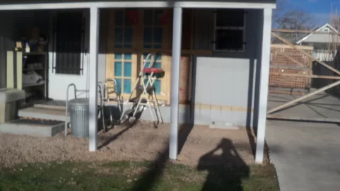

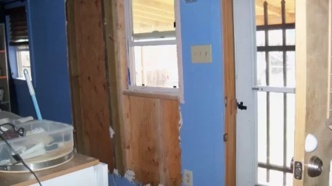

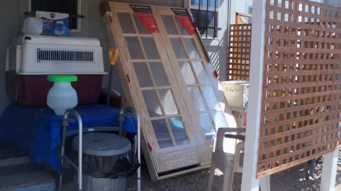

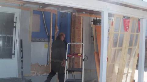

Updating everyone with pictures. French doors are in and the next step is the concrete work on Monday
Trying to get pictures on here...The french doors are in and I forgot how to put pictures on here but this is the few that I got to show all of you on the forum...Work is puttering along and the concrete and insulation will be laid on Monday...Everything is going well and on the time table too. Thank everyone for your good wishes and concern over my brothers death on Good Friday.. But the French Doors are In...Yes....Clancey

Pictures of continuing work above and I am saving every piece of wood that I have left over for the start of my wood pile. Right now I have a old table that is swaying and can not be rescue because of its cheapness upside down and made into a wood pile and a picture would just be too painful to put on here because of what it looks like--lol . This Monday will be concrete and bolt day , then days and days of drying the concrete meaning I can only use the front door--what a drag this will be...but I am game for it....Mrs. Clancey

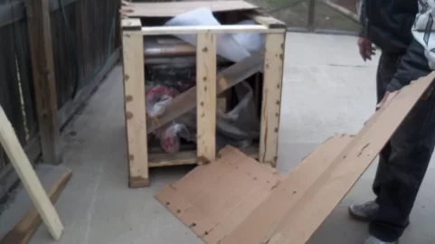

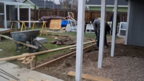

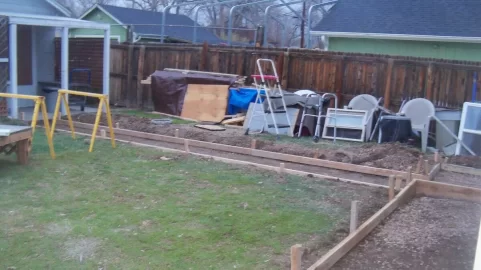

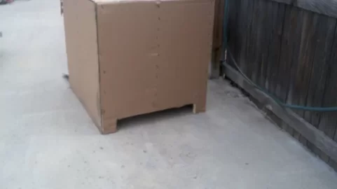

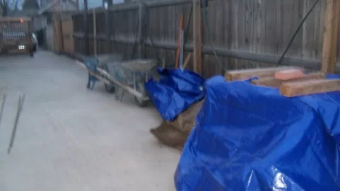

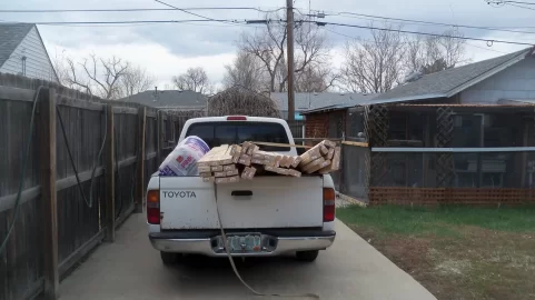

Hard day today and trying to get pictures on.. This gives you the extent of our day. Major concrete work today and will be laid tomorrow, The stove arrived and it #3 and #19 under the blue tarp and I checked it out real good and seems to be okay,, The porch has french doors as well as sliding doors and three windows and the concrete work is 40x25 and 36x25 and 8x15 with steps about 7 feet long 15 wide and 5 inches high and a basement door that needs to be finished..This gives you some idea of the work in progress here and the electrician will be here on Tues as well as the carpenter next week after the concrete is seasoned..Tomorrow they pour it and also put the 1/2 inch insulation material down in the patio area (thank goodness for this suggestion from one of our members from Texas---great suggestion as well as the name of the stuff from Begreen....tomorrow's another day and just wanted to share this with you all....clancey

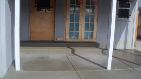

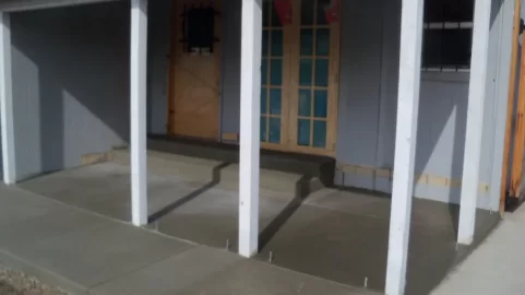

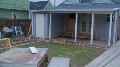

Trying to get just single pictures on here but do not know how to do this...Never know what I am going to pick up from past pictures..Porch concrete work is finished and I cancelled out the other path because I did not like how it lined up with everything and certainly did not want a step going sideways to the basement area----so I had them take out the wood pieces and just do the porch area..They were gracious and nice but not thrilled about the adjustment--lol...They did a wonderful job of work here and their were six of them and I gave them each a five dollar bill for lunch.. Tim, Bill, Mark, and I cannot remember the rest of their names..My new wood stove is covered up real good with bricks all around the tarp because we are going to have "nasty" weather all week--snow and rain...Here is the picture...clancey
